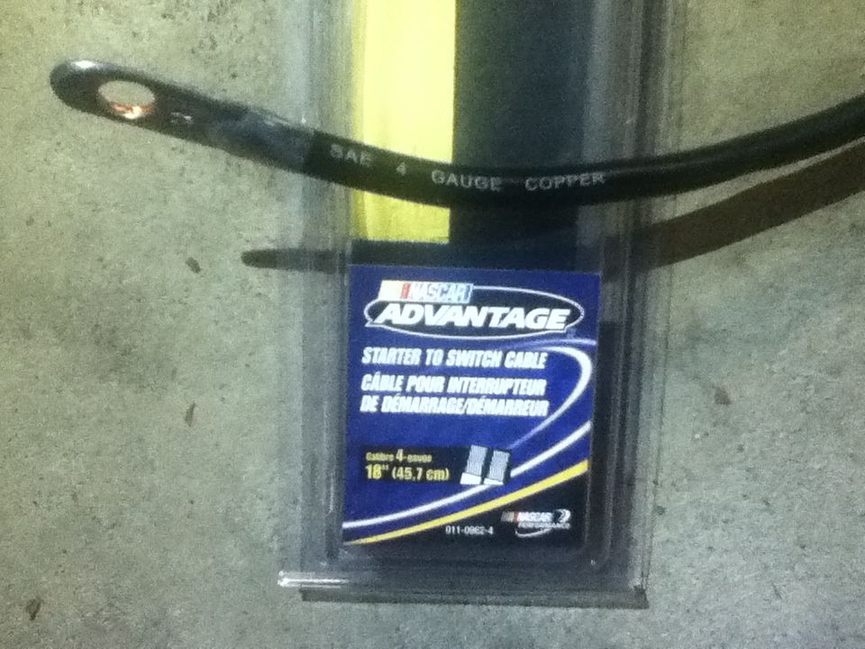

C) I was thinking of using 4 gauge cables that should be much better than the stock cabes.

I would not put much effort into it. The existing cables are more than good enough. The distances in a swift is next to nothing and a metre of cable is nothing... also the motor is dead easy to crank around.
Some install relays on lights to lower loss in cable, but increasing voltage level on lamps decreases lamp life significally. I would rather put my hours on looking over electrical connections and cleaning them. After I use white waseline and an small painters brush to apply it. I apply vaseline on all light bulb sockets and connectors outside of the car and inside the engine room.

I didn't bother running bigger wires from the alternator because it only puts out around 55 amps. The others make a difference when you have a big stereo
