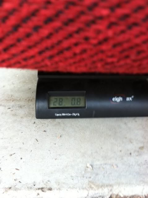

Got a couple things weighed out so far.
Spare jack and associated bits: 4 lbs 8.4 oz
Front seat and rails: 28 lbs 0.8 oz (to be fair, the seat is torn and missing a good bit of stuffing)
I don't have a pic, but I think the spare 12" wheel/tire weighed just under 24 lbs or so. Maybe Kinch can remind me.
The plan for this car is to build it to Street Prepared specs for SCCA Solo racing (autocross).
Long story short: suspension, full interior (race seats, short shifter, aftermarket steering wheel, harness, cage [optional]), stock engine/turbo but with header/intake/exhaust/tune, Rcompound tires, LSD (hopefully), etc. We're allowed to update/backdate with any parts that were available on any USDM sprint from 1985-1988. We ideally want to find an 85 or 86 base model as you would think those are the lightest. However, being as they had leaf springs in the rear, we're afraid that won't work with what we plan for the rears in the future. Unless the rear suspensions (coil vs leaf) had the exact same mounting points. Can anyone tell us if the answer is yes or no?
So at this point, the safe bet seems to be finding an '87 base model (should weigh less than the turbo) and then drop in the turbo3. I'm thinking a lot of that weight savings will be from the lack of trim pieces, center console, passenger mirror, cruise control, A/C, etc. It won't look as cool but it will be faster! :)
