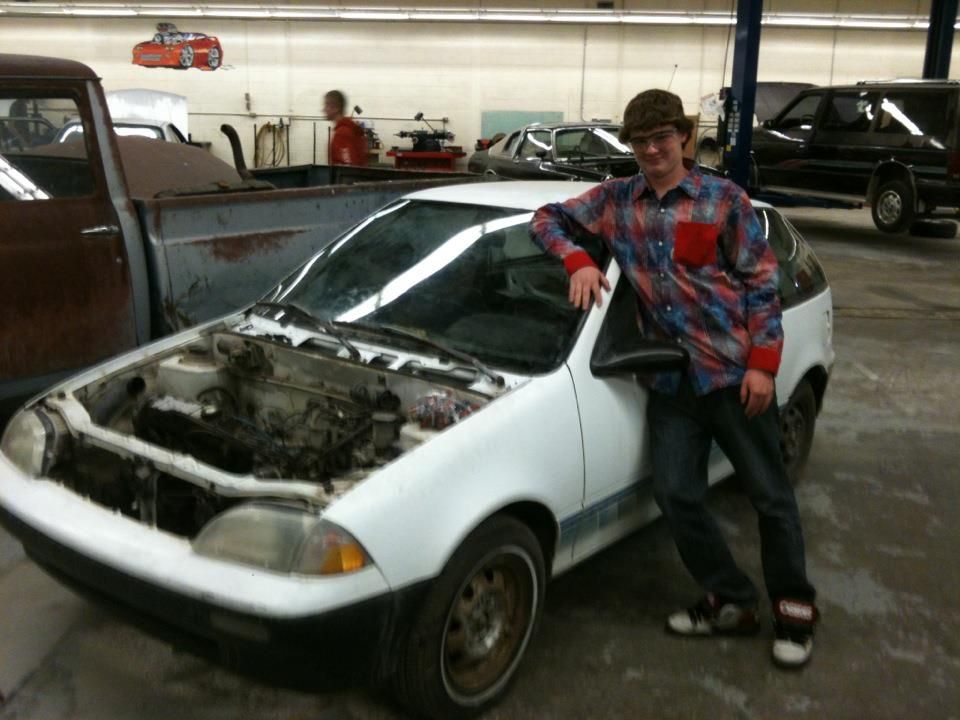

My friend leaning on the car like a goof in our highschool workshop in around 2012. We pulled out the 3 cylinder that was running on two and popped in a low miler g10. Following the swap the wiring issues began, meaning the car was put back out on the farm and forgotten.
I knew that I had to get my hands on the 91' before it began to rot like every single other one I've seen around Saskatchewan. And I'm not really sure what stopped it from being rusty in the first place. The car was driven back and forth to my friends dad's farm (about 45 minutes on gravel each way) for around 15 years, and when the motor lost compression on one of the cylinders it was used by his young kids and himself as a field bomber. But regardless, no rot, which meant it was the perfect candidate for my little g10t.
