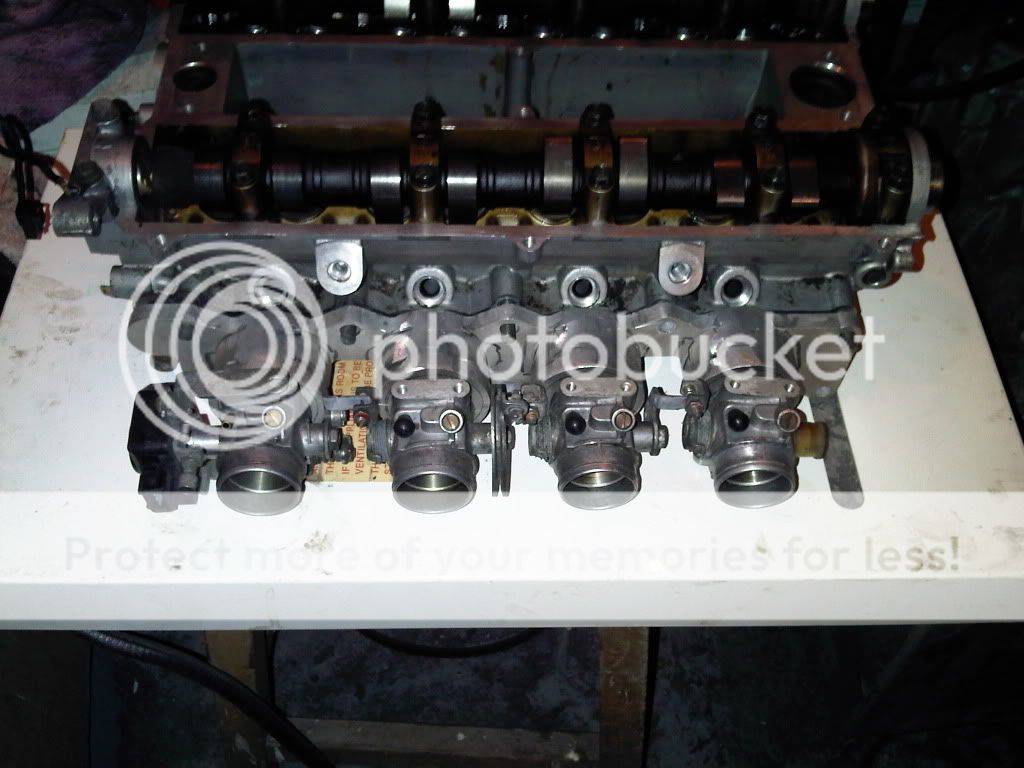

I'm building a ITBs setup at the moment.
This is a photo of it.

This is what it looks like fitted to G13B head.

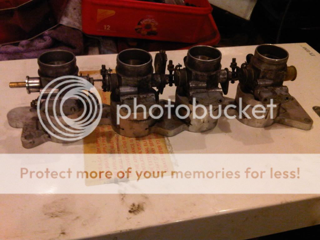

I haven't finished making as yet. I used lasercut to cut 10mm ali plate and 20mm for round to oval trasformation.
I'm thinking of using std injectors...
Once I finish making it, I will load a photo!

I would think that the MAF with the highest airflow spec would be one from a V6 Grand Vitara, whether it will work with a Swift ECU is another matter. The GV is a hot-wire set up with a precision reference resistor in the ECU.
