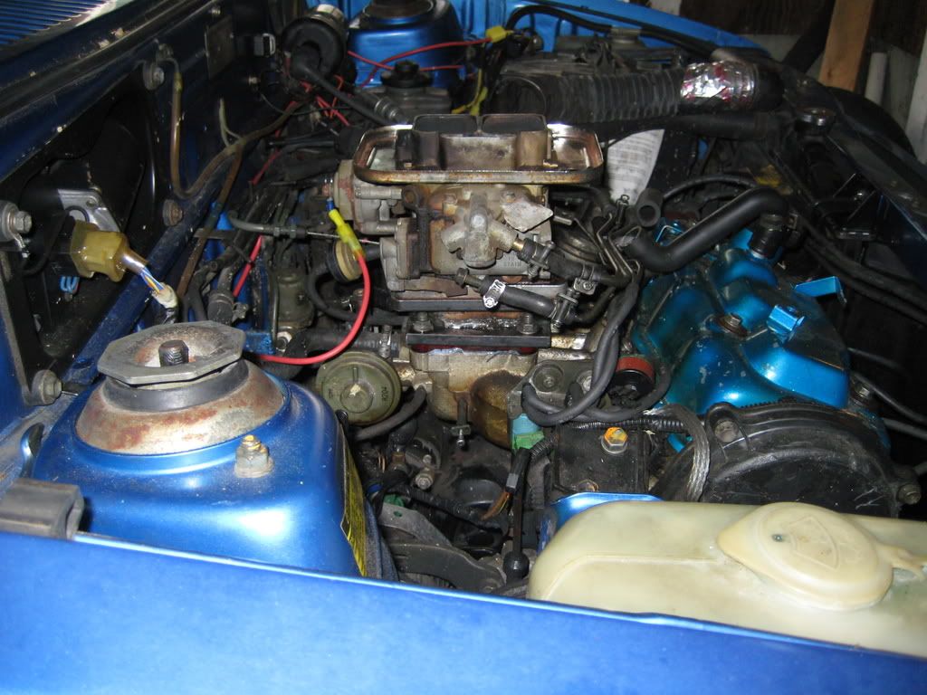

Here's a picture I have it ty raped to the charcole canister hoses
.Image
Works pretty good but when I'm cruze ing above 2g it bucks like a son -o- bitch till I pore the fuel to it (step on the gas).
Then it smooth out aslong as i keep it in the power range
so I need more fuel off idel and i can get there from changing the idel jet and tunning the idel air blead screw making it Richer... Bah bah bah.......
I do like the crisp punch i get with the weber seems like more top end I don't know if it's the carb or my little volocity stack /adapter I made to adapt the carb to the manifiold??/

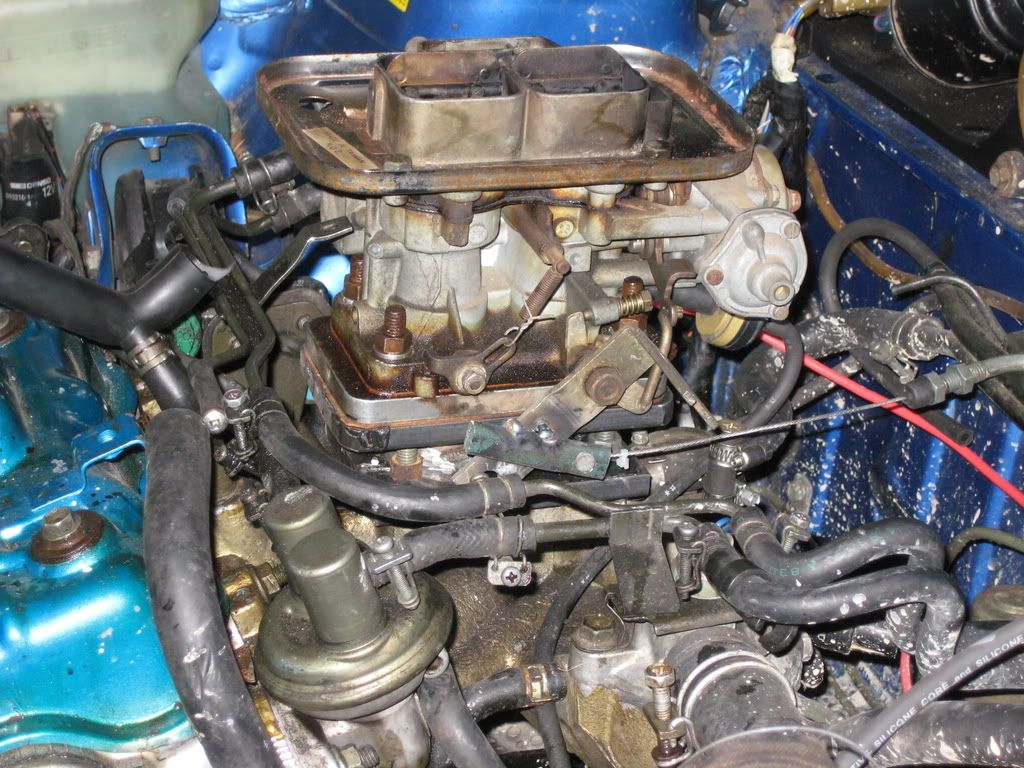

it's a brass plug at the top backside use a screw driver to get it out the jet will be stuck to the inside of the brass plug
HERE's a picture of the Idel jet plug it is just left of the fuel hose see were the dark stain is theres a plug the undo it with a screw driver
here's the post with a picture were to find the jest and what size they should be and how to adjust them
