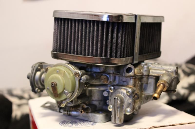

Weber 32/36 DGAV (used) $50 --Thanks craigslist!!!

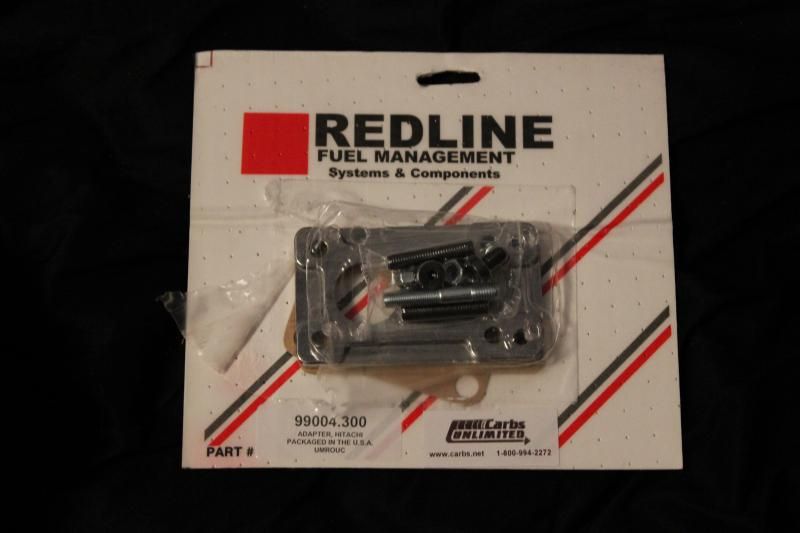

Suzuki Samurai Manifold adaptor (new) $40 --Carbs unlimited
