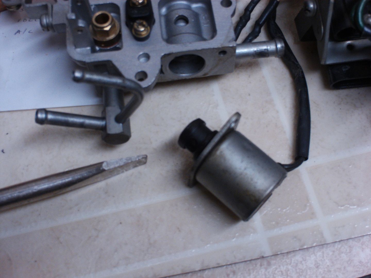

Although you may have heard the term 'bowl vent solenoid' several times on Teamswift, you might never have seen one.
Here's the one which was on the carburetor; the screwdriver is pointing at it:
It looks fine, but there's one huge problem.
It is missing the plunger, spring and a couple of O-rings.

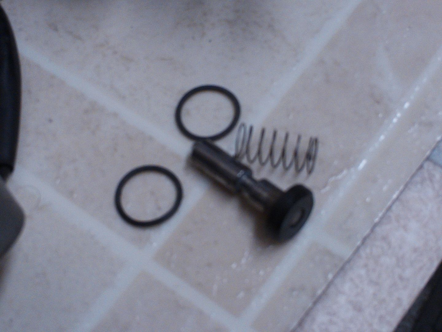

Here is what it should have:
The bowl vent solenoid (BVS) specs out with an ohm meter, but when I put the plunger in, and the unit on the carburetor, I wasn't able to see the plunger work properly when 12 volts DC was applied.
As they age, they can get hot on long journeys; perhaps this unit no longer works?
I'm wondering if the guy figured it would be best to remove the plunger because it didn't work?
What does the BVS do?
When you shut off the car, it seals up the gasoline portion of the carburetor so that the gasoline doesn't evaporate.
That means your carb won't dry up if you leave it sit for a long period of time.
Is that a good thing?
Certainly. It is a HUGE improvement over the old dual pumpers which are vented to the atmosphere and dry out if not driven daily.
The BVS can prevent the build up of varnish inside the carb.
You can see the heavily varnished check ball in the accelerator pump in the picture earlier in this thread?
Removing that plunger may have contributed to that.

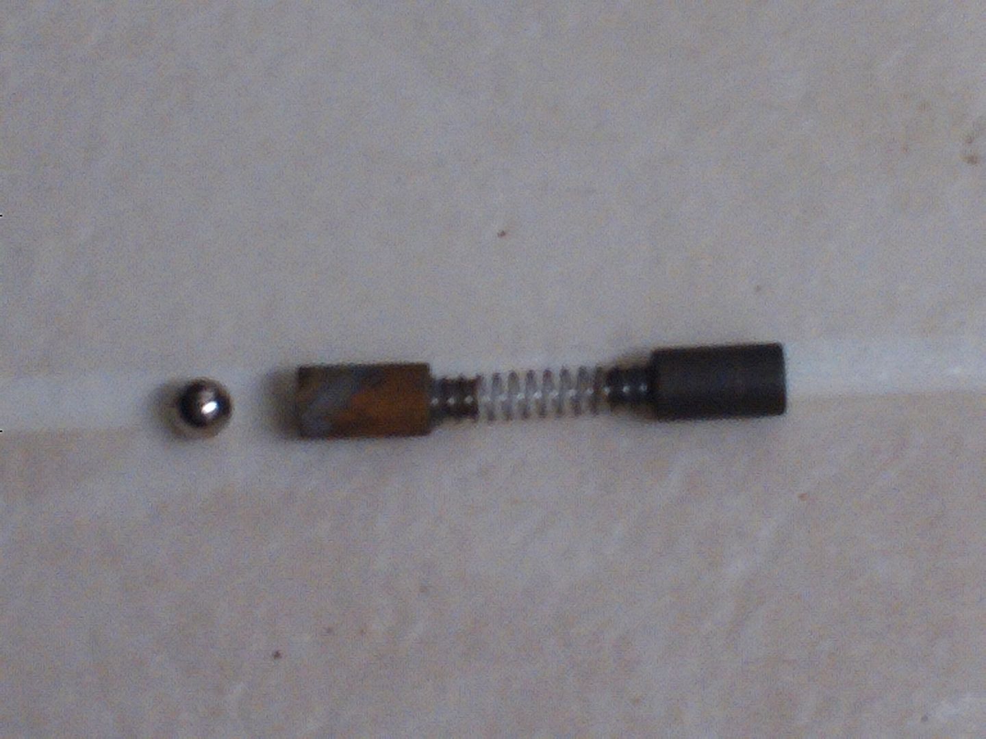

INSIDE that hole circled in red is supposed to be a check ball which is under slight pressure, keeping the accelerator pump area full of gasoline in case a small shot of gasoline is needed.
Here is what is supposed to be there:
From left to right:
-check ball
-brass weight
-spring
-brass weight
Upon disassembly, here's what I found:
-check ball
-brass weight
Our rebuild Dumbo probably lost the two parts, didn't see the need to replace them with new ones or couldn't find some and figured no one would find out.

I doubt there are any of you still following this thread, but we'll add a bit of blah blah blah to an already blah blah blah-ish boring thread on carburetors.
We've talked a lot about 3 solenoids in the carburetor.
In this post, you'll be able to see 2 of them in action.
First, the bowl vent solenoid.
For orientation, let's look at the fuel bowl again:
It is the (mostly) rectangular cavity nearest you in the picture above.
There is a cover which fits over it and keeps you from smelling gas fumes normally.
If we could shrink ourselves to a size that fit inside that bowl and looked up at the cover, that is the orientation of the 10 second video below:
(click to view)
As we energize the solenoid, the electromagnet pulls the plunger back and vents the bowl so that the fuel can enter the engine and air (and fuel vapor) can occupy the top half of the bowl.
This is what happens automatically when you turn on the key and the engine fires up.
It might be interesting to consider what happens if that plunger won't retract and allow fuel vapor from the charcoal cannister and air from the air horn into the fuel bowl.
For now, you can see how it works.
I put a little EZ Turn lubricant on the plunger because it is resistive to fuel and fuel can sometimes soften the plunger seat and cause them to stick shut.
Now it is working normally.

Last, let's cut to the chase, or look at the fuel cut solenoid.
In this video, also only about 19 seconds, you can see how easily they work.
It is basically the same as a bowl vent solenoid with a few minor changes.
First, the plunger is metal.
Second, O-ring has been moved to the area where the solenoid bolts to the carb body.
Take a look at the fuel cut solenoid (removed for easy visualization) and see how responsive it is:
(again, click for a 10 second video)
The purpose of the fuel cut solenoid, as mentioned many times on this site is to shut off the fuel to the IDLE CIRCUIT when you turn off the key.
Dieseling, or a condition where the engine continues to run on its own compression when hot may occur if this solenoid isn't present or has been disabled.
This fuel cut solenoid (FCS) is a part which seldom goes bad and seldom gives a mechanic problems.
Unfortunately, it is often classified as 'smog sh*t' and looked at with disdain by bumpkins.
Is there any down side to a FCS? Not really.
Are they a good thing to have on a carburetor? Absolutely.
It adds expense and some complications, but there is a reason it is installed.
Now you've seen one in action and they are very responsive, like the BVS.
That covers 2 of the 3 solenoids on the carb.
The MCS has been covered a lot by mkc1962 and glacierburst.
Let's confine this post to the BVS and FCS.
The two solenoids are now working in this super clean carburetor.
