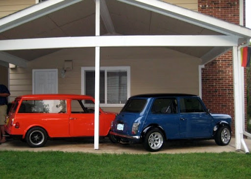

Oh, and I know people like pictures. So here's mine that I am almost done with. Can't wait to get the Suzuki swap started.
